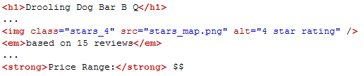

Vậy là còn mỗi cái: Microformats (có bác nào hiểu cái này không?)
To display Rich Snippets, Google looks for markup formats (microformats and RDFa) that you can easily add to your own web pages. In most cases, it's as quick as wrapping the existing data on your web pages with some additional tags. For example, here are a few relevant lines of the HTML from Yelp's review page for "Drooling Dog BarBQ" before adding markup data:

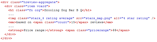

and now with microformats markup:

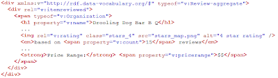

or alternatively, use RDFa markup. Either format works:
